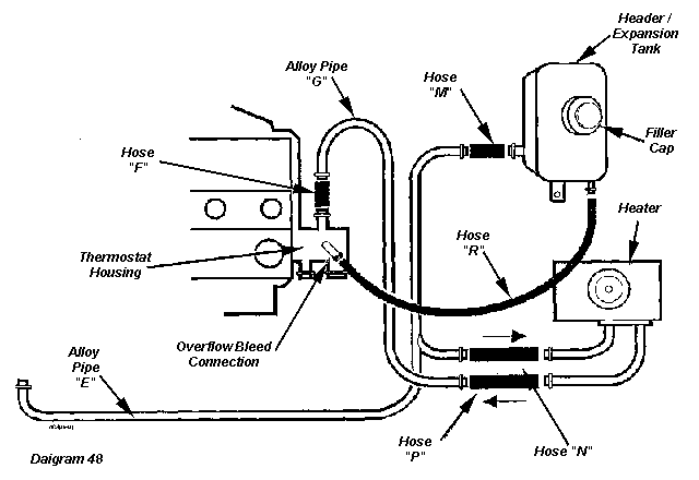

Diagram 48 Non Ducted Nose – Shows the connection of the heater and expansion tank connections. The arrows showing the direction of flow in and out of the heater are incorrect. Hose “P” is the inlet to the heater and Hose “N” is the outlet.
The Westfield expansion tank is considerably smaller than the one fitted to the Mondeo.

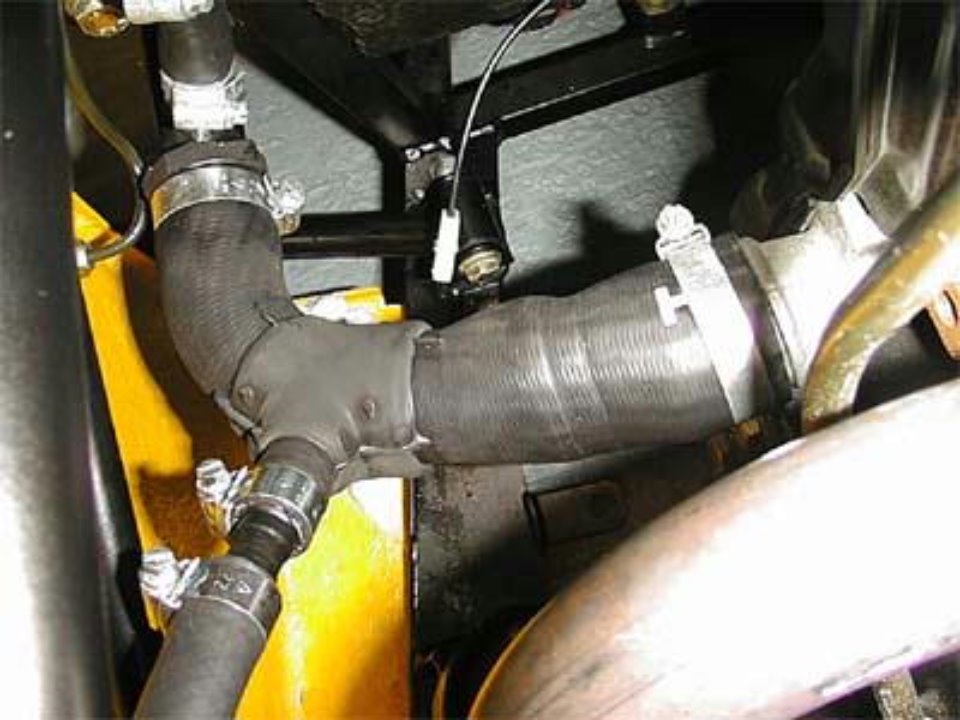

The photograph, above right, shows the modified bottom hose alloy pipe on situ,. The right hand junction is connected the heater and the left hand junction is connected to the new bypass pipe.
A suitable bypass pipe can be manufactured to the approximate dimensions as above. Made from 16mm alloy or copper tube with a bend formed at each end. The downward end, which connects to the modified alloy bottom pipe is formed at 15˚ from the vertical or 75˚ with respect to the horizontal junction, which connects to the thermostat housing. Anti blow off ridges can be made by running a weld round the circumference of the pipe. If copper pipe is used suitable bends can be made from “Yorkshire” solder fittings.
The photograph shows the new bypass pipe connected to the modified bottom hose alloy pipe and routed alongside the heater pipe. The bypass pipe and heater pipe are secured together, at regular intervals, using pipe / wiring clips available from Vehicle Wiring Products.

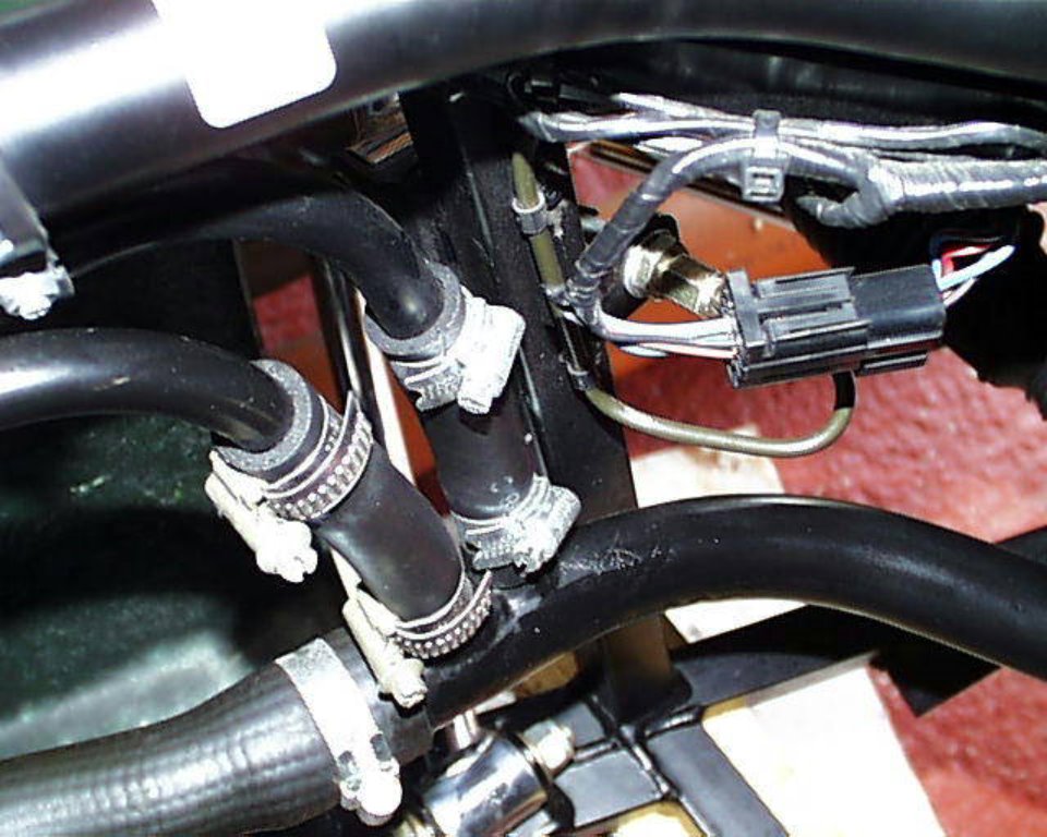

The photograph above right shows the connections to the Thermostat housing. The thermostatic switch (blue plug) can be seen, fitted in to the pipe from the main thermostat-housing outlet. Beneath this pipe is the rubber hose connecting the new bypass pipe to the thermostat bypass outlet. The blanked off connection in the main pipe was made using a ½” BSP adapter and an M10 Bolt. The pipe was tapped to ¼ ”BSP thread and the adapter was, internally, tapped to match the M10 bolt. The ¼ ” BSP adapter was wrapped in PTFE tape to seal it and screwed in to the pipe. The M10 Bolt was similarly wrapped in PTFE tape and screwed in to the adapter. This arrangement has proved watertight
The Photograph (above left) shows the coolant pipe running down the Left had side of the body. The alloy pipes are fastened together using pipe clips to provide a neat and secure installation.

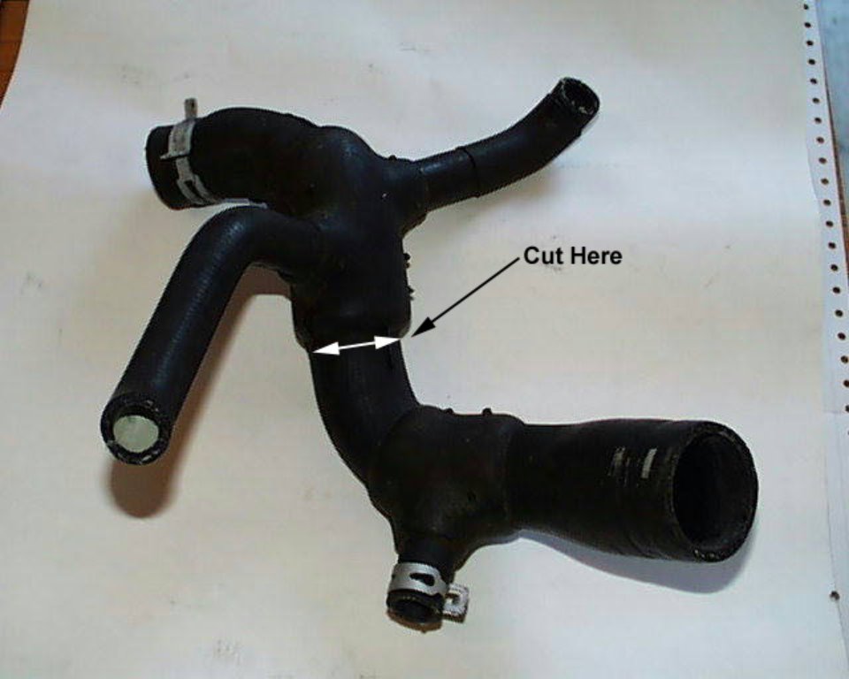

The water pump inlet on Ford Zetec 1800 is at right angles to the cylinder block. This facilitates an easier solution of the bottom hose connection, to the thermostat bypass pipe. Using the bottom hose connection from a Ford Mondeo. (Ford FINIS No: 1013384) (Left)
The modification involves cutting the Mondeo hose almost in half, just in front of the reinforced section with the multiple branches. This end would normally be connected to the Mondeo radiator can be discarded. The remainder provides an angled pipe with a single branch that can be used to connect to the thermostat bypass.
A separate bypass pipe is still required and can be made from ½” hose connected to the thermostat bypass outlet and clipped securely to the existing coolant pipes. In line pipe connectors of plastic or alloy can be used to join the bypass pipe to the Mondeo hose. Care must be taken with this installation to ensure coolant flow is not restricted by hosepipes that are kinked or distorted.
