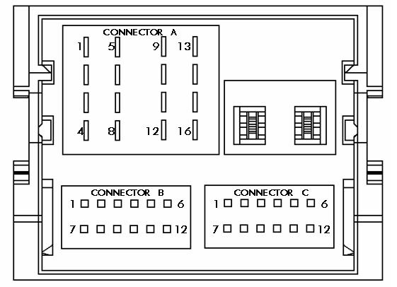

Hej alla ...
Någon som har koll på vilka kablar det är som är högtalar kablarna i orginal kontakten till stereon på en Mondeo 2008 ?
- Inlägg: 7153
Hittade det här:
Connector A
Pin 1 Right Rear + (brown/white)
Pin 2 Right Front + (purple/white x2)
Pin 3 Left Front + (white x2)
Pin 4 Left Rear + (brown/green)
Pin 5 Right Rear – (brown/blue)
Pin 6 Right Front – (orange/white x2)
Pin 7 Left Front – (white/brown x2)
Pin 8 Left Rear – (brown/yellow)
Pin 9 CAN + (blue/white)
Pin 10 CAN – (purple)
Pin 11 Keycode Ground (black/blue)
Pin 12 Ground (black/blue)
Pin 13 Alarm Sense (From GEM) (yellow/grey)
Pin 14 Illumination (not used)
Pin 15 Battery + (From F72) (brown/red)
Pin 16 Ign. Sense (Accessory) (From F69) (not used)
Connector A
