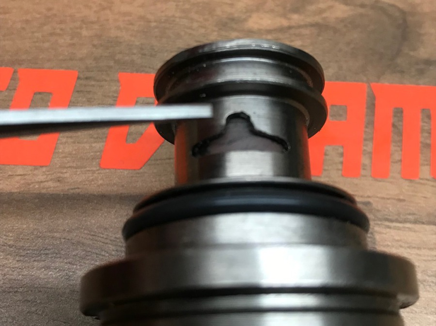

The springs tend to go weak with age and compression cycles, and sink, this means the valve passes air when it shouldnt and opens to easily. so with the piston sat in the valve body i aim to see the piston around 2mm under the top face of the valve body, reomve the piston and stretch the spring, or contract the spring to get this height correct.
The piston has a small scribe part way down its body, aim to get this scribe line exactly inline with the top cut out in thre valve body air port.
Scribe line shown above
Scribe line can sit exactly on the top of the Air Pass cut out indicated.
The piston will sit around 2mm under the top of the valve body once this is done.
Once this is done and you are happy with the spring height, give the piston a few pushes and work the inner spring, it should push the piston back to its optimum height each time!

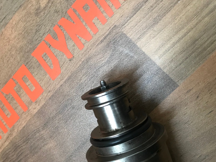

Then your almost there, refit the outer spring, refit the plastic retainer, and apply a small amount of thread lock tho the thread, put the nut back on and tighten. Do not go mad and wind the nut all the way down, just take it down a few mm, leave around 3mm of thread showing above the nut.
Finally some more lubrication can be applied through the air ports on the side.
You can now replace the o rings, after cleaning and inspecting them. Replace if necessary and ensure there are two!

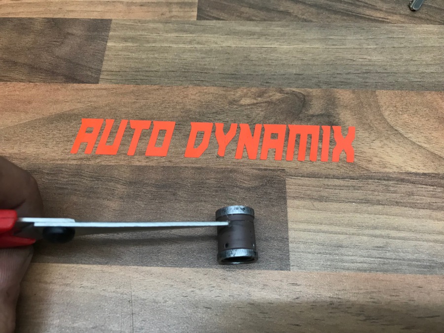

We need to be aware of the drilling shape of the valve body, you see the cut out has a small "lump" cut away from it, where we line the piston up with earlier, this is to allow the ecu to command the valve to open, but not make the RPM jump by adding too much air, its a progressive bypass.
So in order to keep the valve functioning as an ISCV we can keep the progressive drilling but enlarge it to flow more air.
Using a dremel, or similar you can neatly file the port size to a more triangular shape, increasing the flow by around 50% but beacuse its still progressive and starts small the ecu will still be able to control idle speed. Once the ALS is active and the valve is pinned flat out it will open the whole port and flow lots more air.
Something along these lines will keep the valve operating as an ISCV keeping a nice cold start.
If you want to pass even more air, you can drill extra holes in the side of the valve body, but ensure they are BELOW the top height of the standard drilling. So as the valve begins to open for small idle speed increases these drillings are not opened. The large ports will operate only when the valve is opened by large amount.
